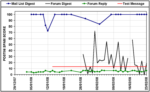

« Reply #16 on: February 24, 2008, 01:53:20 am »
OK, not enough time to do much in the way of analysis other than a quicky look this week I'm afraid. Volume is up on last weeks all time low but there were no false negatives at all this week.  Still a fair few false positives tho and several missing messages but I have been getting some (although apparently not all) coming through from senders where all messages started being blocked 2 weeks ago. It's all been a bit strange and somewhat inconsistent to say the least recently with the sudden dip in spam, the apparently associated increase in missing mail and then a sort-of recovery this past week. Still no comments from PN Sad but I have seen a few other customers noting an increase in false positives and possible missing mail over the last 2 weeks as well. Anyways, graphs for your viewing pleasure follow:
WARNING: The e-mail address on my profile is not my usual address, all messages sent via this site have been redirected elsewhere for test purposes. This could result in messages not being received in a timely manner or potentially not being received at all.

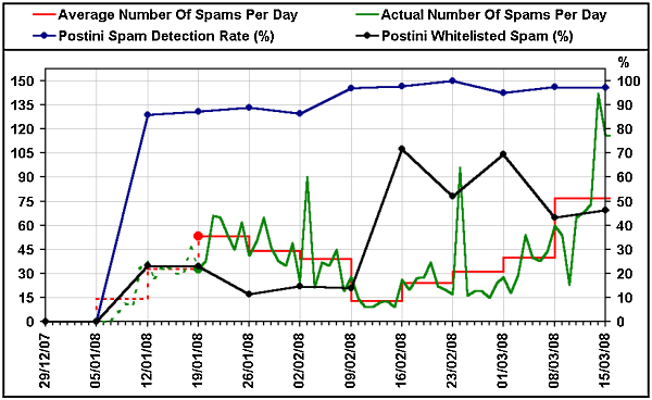

« Reply #17 on: March 02, 2008, 12:43:39 am »

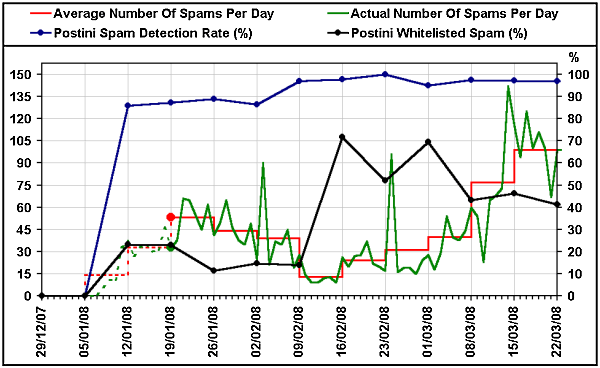

Well, here we go again and still no time to do anything much except bung up the graphs and disappear I'm afraid. I still have almost a months worth of genuine e-mail virtually unread and certainly not responded to at the mo Sad so the absolute last thing I need right now is to go trawling through shedloads of mail to try and establish exactly which did and which did not get eaten by postini !  Still some very obvious false positives tho and still some mail apparently going AWOL.  Reporting "spam" and "not spam" appears to be a complete waste of time and effort as no action appears to result from filing many reports.
Anyway, it's all gone a bit odd again this week.  Another major spike in volume last Sunday but nothing particularly unusual as this sort of thing has been seen before.  However, performance is very much on a downward trend again due to what appears to be a shiny new flavour of spam arriving as of a couple of days ago or, given the date, possibly due to a postini update c*ck-up which is now letting it flood through. Either way, let's see how long it takes postini to respond to the problem this time ... and hope that PN finally get around to responding to postini's apparent changes from some considerable period of time ago of course.
I'm very concerned about the apparent total lack of configuration management so far as the PN/postini system is concerned. Questions have been asked several times now on the PN forum and 'reminders' have been given about 'over-looked' posts containing important points but still no response and some of these go back almost a couple of months now to around the time the "2strike" issues came up. Very suspect methinks. Anyway, it would appear that postini potentially make changes to headers willy-nilly and PN either do not realise that this could break (or has in fact broken ?) their implementation and do not take any appropriate action. It would also appear that some customers have a fundamentally different postini configuration to other customers. All in all, I find it most concerning that no one appears to know what's going on and why ... or even cares enough to find out in a timely manner.

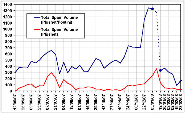

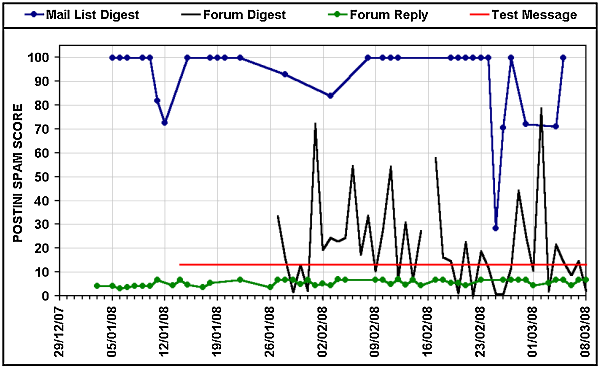

« Reply #18 on: March 09, 2008, 12:44:18 am »
Still no time for too much messing around but here are this weeks stats for those who may be interested. Going up .....

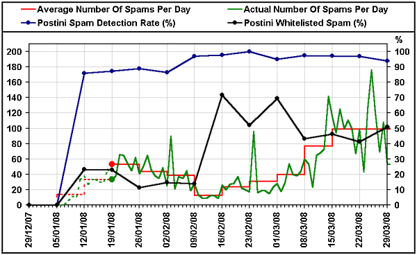

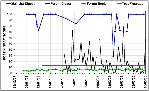

« Reply #19 on: March 16, 2008, 12:29:15 am »
Hmmmm, for anyone who hasn't noticed, it's not been a particularly good week on the old spam front. An all-time (postini) high Sad  Plenty of it in general and plenty of it getting through largely unscathed as well.  Volume still very much on the upward trend and several more new flavours that are doing a real good job of getting around postini along with those that have appeared over the last couple of weeks and, to a certain extent, also managing to bypass the PN tagging as well.
One of the new flavours is being handled particularly badly by postini and demonstrates yet another serious short-coming in their detection algorithms. An intentional or simply erroneous line space in a (very badly) forged routing header technically makes all subsequent headers part of the message body.  However, good old postini appear to be accepting all the invalid headers rather than seeing the message as a serious non-compliance with RFC822 and rejecting it outright. The message should be considered totally non-compliant because the "to", "from", "subject", "message ID" and other fields are effectively not present despite some of these being mandatory not optional.
Their processing is totally inconsistent though because they then go on to add their own headers after the stray line break and before all the invalid headers that they had previously accepted and used for routing and analysis purposes. A very poor show and the result is shedloads of them sailing through, aided and abetted by Mr.Whitelist of course.  postini still don't appear to have caught up with the last batch of new flavours so god knows just how long this latest deluge is going to last.  Mr.Spammer is very much better at finding holes than Mr.Postini is at plugging them it would appear.
In addition to that, the PN "subject line tagging" process is (quite correctly) not finding the subject field in this particular new flavour of spam because it is buried in the message body but unfortunately it is rather stupidly doing nothing at all as opposed to simply adding a valid "subject" header with "-SPAM-" in the appropriate place in exactly the same way as a valid "message ID" is added when this is missing.  Any message with a blank, missing or incorrectly placed "subject" field that requires tagging is currently being ignored.
All in all, a bad week necessitating one graph having to be re-scaled. Still no obvious improvement on the false positives and missing mail front either, if anything it's getting worse.  What exactly are PN doing with the "spam" and "not spam" reports ?

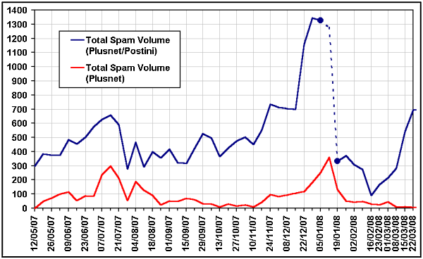

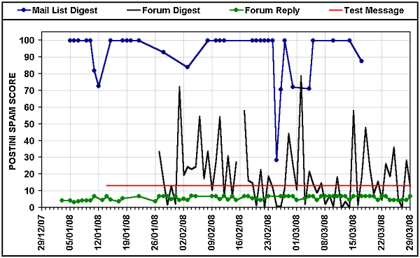

« Reply #21 on: March 23, 2008, 12:47:25 am »
Onwards and upwards and all that Sad  Somewhat unfair comparison but I'm thinking ye olde vanilla flavour PN spam filtering is performing significantly better than the shiny new improved recipe with added postini flavour at the mo.

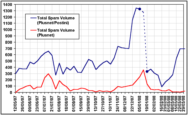

« Reply #22 on: March 30, 2008, 12:32:58 am »
Well, at least the seemingly never ending upward trend has levelled off at last Smiley  It was looking *really* bad early in the week with a daily volume hitting an all-time high (necessitating yet another re-scale of the graph, I'm afraid) and a detection rate nose-diving to around 80% but it's recovered a bit since then. Still well out of spec tho.  In fact, over the 12 weeks that I've been on postini, only one week has actually achieved the Detection Rate SLA (although some are pretty close) but I have to cheekily suggest that was perhaps a bit of a fluke because on the particular week in question there was next to no spam and no false negatives !  The SLA for False Positives is still, needless to say, several miles away from reality of course without any need to work out an actual figure.  The very fact that I've had more than 1 in several years absolutely guarantees that it's not being met !  Virtually all of the false positives (and ridiculously low scoring messages in general) that were first seen some 12 weeks ago are still appearing much the same this week. So much for investigating not-spam reports, training the filter(s) and/or correcting fundamental errors in the algorithms Sad

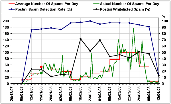

« Reply #27 on: April 10, 2008, 01:59:02 am »
I was very much hoping to find that on my return almost a week after this started, all would now be well and the newly introduced problems would be fixed. Apparently not it would seem. I'm still seeing all the same issues that began last Thursday and service.status hasn't even been updated as planned in the meantime either.  So, it's back to beating Mr.Head against Mr.Wall it would appear to try to spell out exactly why I think this is wrong and that the problems were introduced solely by PN action last Thursday whereas PN obviously seem to think all is not that bad at all and in any case, no other customers are having similar problems - it's just me.
EXPLANATION OF PREVIOUS COMMENTS FOR THE NON-BELIEVERS
Every single mail received up until around 1200 last Thu has looked something like these 2 recent examples:
Quote
Delivery-date: Wed, 02 Apr 2008 22:04:17 +0100
X-pstn-levels: (S: 0.00000/53.65985 CV:99.9000 R:95.9108 P:95.9108 M:97.0282 C:99.7951 )
X-pstn-settings: 1 (0.1500:0.1500) cv gt3 gt2 gt1 r p m c
X-pstn-addresses: from <fkeqsh@My_Account.force9.net> forward (user good) [21/1]
X-pn-pstn: Spam 1
Quote
Delivery-date: Thu, 03 Apr 2008 11:39:10 +0100
X-pstn-levels: (S: 0.00000/54.71812 CV:99.9000 R:95.9108 P: 0.0000 M:97.0282 C:98.6951 )
X-pstn-settings: 1 (0.1500:0.1500) cv gt3 gt2 gt1 r P m c
X-pstn-addresses: from <qe@My_Account.force9.net> forward (user good) [21/1]
X-PN-Virus-Filtered: by PlusNet MXCore (v4.00)
X-PN-Spam-Filtered: by PlusNet MXCore (v4.00)
as indeed they have done since just about day 1.  Not necessarily with a forged whitelisted address of course although the majority did last Thu but that is not particularly unusual in itself.  Also, up until this time, I was receiving the sort of quantity of messages that I would expect to see. Although, it was somewhat unusually lower than normal for around midday and quite noticeable that most messages had been received prior to 0600(ish) with only a very few thereafter. The 2nd example above just so happens to be the very last message I received before things apparently changed once again.  Note that header changes are already apparent by now. The missing SPAMx header is a well known error that PN had introduced by this time of course.
All subsequent messages have looked something like this:
Quote
Delivery-date: Thu, 03 Apr 2008 12:19:55 +0100
X-pstn-neptune: 51/50/0.98/87
X-pstn-levels: (S: 0.59202/99.77803 CV:99.9000 )
X-pstn-addresses: from <shedricknf@wwdb.org> [db-null]
X-pstn-neptune-cave-rslt: qtine
X-pn-pstn: Spam 2
and not only are they clearly quite different but messages in general were also very conspicuous by their absence after this point. Virtually no messages were received after around midday.  In addition to that, those that were received were all false negatives for one reason or another.
Portal configuration was checked and put right around midnight after it became apparent that yet another PN error had led to them being changed to inappropriate values. Despite this action, last Fri saw a continuation of the trend from the previous day. Virtually no messages being received at all and those that were received were false negatives.
Much the same trend again for last Sat excepting for the fact that a small deluge of NDAs was received during the day. This is the first time ever (in ~10 years) that NDAs as a result of one of my addressees being forged in a spam dump have been received. It's almost certainly pure co-incidence that it happened at this particular time, although there is a slim possibility that it's not I suppose. Configuration options were checked, found to be correct but 'updated' once again anyway but still the problems have continued to date.
Incidentally, postini appear to be completely useless at handling NDAs. They could and should detect them and act accordingly. They could and should detect those that are being received solely as a result of a forged address being used when sending spam in particular. Spammy NDAs could and should be rejected because this is so easy to do very reliably in the vast majority of cases. Only totally genuine NDAs (plus the occasional false negative) should ever be delivered to customers. Sadly, postini don't bother to do anything remotely sensible it would appear so customers can expect virtually unlimited quantities of NDAs should one of their addresses ever be used by Mr.Spammer. I rather suspect that postini will take the easy option at some time and simple dump all NDAs regardless of how genuine and wanted they might be based on their current attitude regarding false positives in general Sad  NDAs are being manually checked and discounted from my data where appropriate because of the severe distortion that would result otherwise.
So, to summarise,
From day 1 until around 0600 last Thu: Just about as expected for most of the time with one or two surprises along the way.
Between 0600 and 1200 last Thu: Uncharacteristically low number of messages being received. Changes started to appear in headers.
After 1200 last Thu: Further header and PN/postini configuration changes were apparent, virtually no messages were being received at all with those few that were received being false negatives. This has continued ever since.
Now tell me that the above sequence of events doesn't tally almost exactly with PN changes taking place and that there isn't something very odd apparently going on as a direct result thereof !!!
But just before you do, let's look at some cold hard evidence shall we just to confirm the situation beyond any doubt whatsoever.  Those users familiar with this and previous threads with my weekly spam stats that have been produced over the last year will no doubt recognise this particular chart which has been detailing postini performance (or lack thereof) since January:
Any doubts now that problems became immediately apparent the very moment PN upgraded the system ? Nope, thought not.
Oh yeah, and talking of problems introduced last Thu, it would appear that whitelisted spam is still sailing straight through untagged despite being blatantly obvious forgeries and not being sent via the PN network.
Now finally, let's address the statement here and elsewhere that it's just me and no other customers that are affected. Really ? It doesn't look that way to me after a very quick scan through recent posts on the PN forum. It seems to me that other customers are also not seeing the configuration they expect happening in reality as I guessed would be the case. I was sort of expecting to be part of the customary "very small number of customers affected" but even I was surprised at the initial off-hand suggestion of being unique here. It is always difficult for me to believe the "very small number of customers" line in most instances anyway simply because I always seem to be one of the "very small number of customers" no matter what the problem is or when it occurred. However, whilst I acknowledge that it is technically possible that these problems are only affecting my A/C, I would suggest that it is just about as close as it is possible to get to implausible for that to be case. >200K customers and the only one of them being affected just so happens to be the only customer who is monitoring PN/postini performance in great detail and on a regular basis so can spot problems immediately ? I really think that there's a greater probability of winning the lottery than that being correct TBH.
I would very much suggest, as I did last week, that these problems are very much a PN problem and they were introduced at the same time as the 'upgrade' and it does affect at least some other customers in one way or another.  All the evidence points to some fundamental problem with the way PN is setting (or rather not setting) the postini and/or PN configuration. At best it is unreliable or at worst it simply doesn't work.  The postini configuration in general has changed subtly from what had existed prior to the upgrade for absolutely no obvious reason and user changes via the portal are not necessarily being acted upon correctly. The end result is that the portal shows one configuration whilst PN and/or postini is merrily doing something quite different. Who knows which options work and which don't or which bits of configuration data are being updated correctly and which aren't and whether it's consistently wrong or intermittent. But the fact is that some options/configuration aren't working and it could apply to any/all options and as suggested last week, this problem simply has to be affecting more users than just me ... and it is of course.  I trust that PN will eventually appreciate this and unlike previous similar reports such as different customers having different postini configurations, not simply ignore the issue because "it couldn't possibly happen" ... and then quietly fix it several weeks later without making further comment. Maybe it's already been mostly fixed, I don't know because I haven't been here watching but what I do know is that at least one of my A/Cs is still acting very strangely, the other being a bit suspect.
Bob, as requested I will PM you details of one A/C that is particularly affected by this so you can see for yourself first hand. HOWEVER, at the risk of sounding just like your mum, remember that you look with your eyes and not with your fingers !!  Please DO NOT go tweaking my A/C settings in any way or go playing trial and error somewhere. The object of the exercise is to see what's going on, go away and find out why and then fix it properly not to generally fiddle about until the problem sort of goes away by itself. Apart from anything else, with several days worth of stuff to catch up on and shedloads to do in any case, I simply cannot deal with several thousand messages suddenly appearing right now, especially as most if not all of them will be incorrectly tagged or have incorrect headers and thus will not be automatically handled, collated and filed correctly on receipt as they usually are.  Once PN have resolved the problems and everything is once again working as it should be, THEN is the time to discuss how to recover from the situation and find/deliver all the data that has been lost over the past week.
I'm not going to be looking at this thread or elsewhere for that matter for a couple of days or so but I would very much like to actually find some GOOD news when I next return along with some GOOD news on service.status for a change.  It's now a week since these problems were introduced after rolling out an allegedly tested upgrade. If it can't be fixed in a week then it clearly wasn't a minor bug that somehow managed to remain undiscovered during the review/testing phase.  Also, a full explanation for why the postini configuration was fundamentally changed at around midday last Thu wouldn't go amiss either seeing that the roll-out took place something like 6 hours prior to that, bug fixes only after that presumably.
